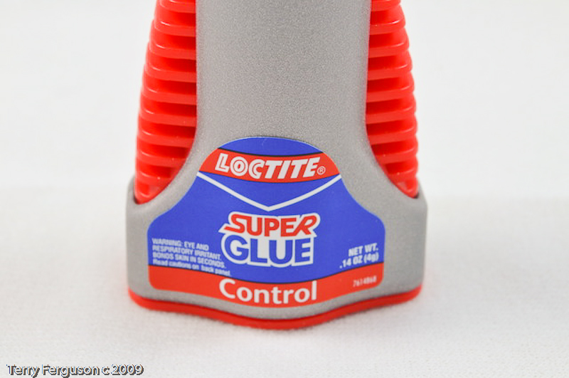

    Here is a shot I took in the light box using glossy white poster paper as the background.
    Attachment 75168
