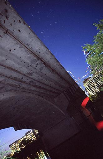

    On the other hand, you never know what you'll get with somebody else's light. Here in Austin about five years ago, we watched the bats take off at dusk. Some guy had a huge flashlight with a red filter on it and at first I was a little disappointed because he kept using it (I have no idea why). I did kind of like the result though. The lighthouse - because it's consistent and spreads the light across the scene by rotating - might do something interesting too.
