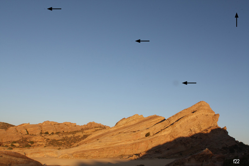

    I've just moved from 35mm film photography to digital, so am on a VERY steep learning curve here!
    I have a Canon Rebel XSi with the standard kit lens, and also bought the Tamron 11-18mm ultra-wide for landscapes etc.
    I was out this morning taking pics, just messing around, changing settings etc, getting used to how the camera operates... too many buttons!
    I was shooting RAW only, the camera set at ISO 100, and when I got home and downloaded my shots I was horrified to see what I can only assume are some kind of lens anomaly/defects in the Tamron lens.

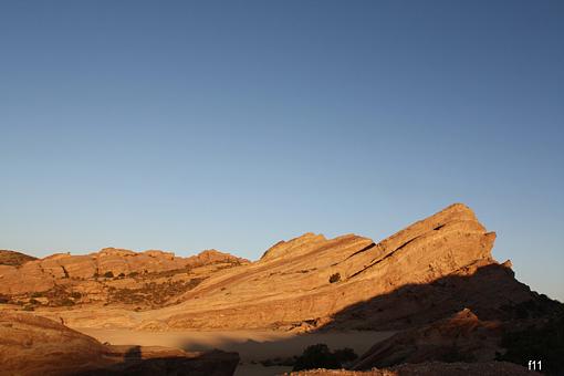

    In the first example below the lens was set at f22, which shows up the "smudges," and in the second, taken just seconds later, the lens was set at f11, and it's clear.
    I've only ever used Canon and Tamron lens' in the past and have never seen anything like this... can anyone offer any suggestions?
    This is particularly worrying for me as I often shoot landscapes at f22 and set the hyperfocal distance for maximum Depth of Field.
    Hope you can help!
    Paul

    Those are dust spots. It means there're dust particles on the sensor of your camera. They show up better when you stop down like at f22. At f11, they're like out of focus/burry and so you don't see them that easily. To deal with them, clean your sensor or clone them out of your image in the post-processing software.
    So you just found out one thing that digital photography differs from film photography: dust on the sensor. I mainly used primes when I shot film and so I changed lenses very often. Back then, I never had to worry about dust...or at least it was easy to deal with. Now, whenever you change lens, dust could get onto your sensor. And when you're not careful at cleaning your sensor, you ruin it

    Welcome to the Forum Paul. Yup, that's dust on your sensor. It's a very common issue, and pretty easy to fix. There are some special sensor cleaning kits you can buy, but I have never used them. All I do to clean my sensor is to us a rocket blower like this one to remove it.
    http://www.bhphotovideo.com/c/produc...r_Blower_.html
    Don't use the compressed air in a can! If you do a search on the forums for sensor cleaning, you should be able to find some more info on how people do it.
