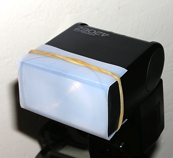

    The best solution to this is to make your own version of the plastic ones they sell for 20 clams.
    Finish a gallon of milk (or juice). Rinse the jug thoroughly with hot water. Find the flattest part of the jug and cut it out. Then make it into a rectangle as wide as the flash head and three times as tall. Then fold it using a ruler or straightedge to get sharp creases. You will fold it so it ends up with three identical panels, the center one of which you put in front of the flash tube. Using a rubber band as was described for the handkerchief idea and shown in the attached image, secure the plastic in place.
    It will end up looking a lot more professional than a hanky and it will allow more light through. You can double two of them up to get more diffusion. My estimate is that one of these diffusers cuts about 1/3 to 1/2 stop off the flash power (non-scientific guess).
    Also, when you have the rubber band in place, it gives you the ability to stick a white card under it to get some forward bounce when you are shooting with the flash head in a more verical orientation.
    The two pics illustrate the diffuser on my flash and how to insert the white card. This system works very well for me and costs nothing. The plastic is durable and easy to clean. Oh, and the blusih cast to the plastic in the pics is the fault of the digital camera I borrowed. This method does not alter the color of your images at all.

    You guys have been great! I cannot thank you enough for taking the time to explain that to me in more detail. I guess I was over thinking it. I am almost done with a gallon of milk and I have a new way of recycling some of that plastic. Thanks again!
