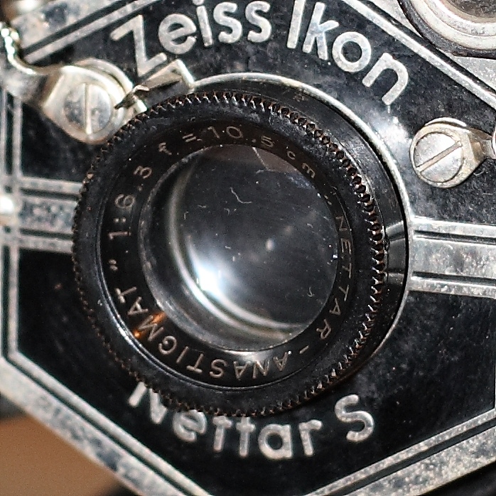

So this is my latest eBay find - $17 to my door. It's a Zeiss Ikon Nettar 515/2 6x9 120 film folding camera. The lens is a Nettar Anstigmat F/6.3 105mm. From the hexagonal shutter plate, it must have been made in 1933 or 1934, as after that all the plates around the shutter were round. It's in fully working condition - the bellows look to be in excellent shape considering its age and they're light tight (dark bathroom flashlight tested). The shutter seems to be dead on at all speeds, the aperture adjusts fine, and the focusing is very smooth.
Negatives: The body is very well worn, particularly around the edges. No functional damage, but it won't win any beauty pageants. For its age and price though, I really don't care about that. The whole camera is a bit dirty - dust, dirt and grime are in most of the little nooks and crannies, with a couple very minor rust spots inside parts of the back. The lens looks mostly clear, but is either a little dirty or has some very light fungus; I can't quite tell. Looking through it is very clear unless held up to a light at an angle, only then can you see a little something that looks almost more like a smear; I haven't tried to wipe it off yet to see.

Overall, it needs a bit of a cleaning, but that aside, I'm pretty happy with it. It's not going to be shot much; just enough for fun and every so often to keep it functional. It will spend most of its time on the mantel. Here are a few shots of the lens. The one from the inside is with a strong light at an angle, a little underexposed, so it looks worse than it really is. But as you can see from all the shots, there's definitely something there. Fortunately, the front element focus stop is just a set screw, so it should be very easy to take that out and get the front element off. From there, I wouldn't have a clue of what to do, so if anyone has any tips, hit me with 'em!
