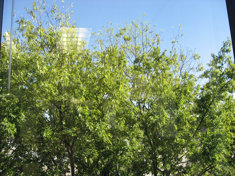

    Here are 3 example photos taken in succession:
    ISO 200
    ISO 400
    Auto
    Every setting <= ISO200 is the same and every one >=ISO800 is the same (inc. auto).
    However 10 minutes later I tried the same thing and AT FIRST the Auto setting AND the ISO80 setting game me the light picture. After changing the ISO a few times though it reverted to the sequence above.

    Ok I learned that there is metadata in the image files so I did some more experiments. There seem to be 2 situations broadly once I turn the camera on.
    1. All pictures turn out normally (light)
    2. Pictures in Auto mode (or Auto ISO mode) and low ISO values turn out dark and high ISO values turn out light.
    In case 1. I see the following combination of ISO-aperture-speed (light/dark)
    80-f/2.8-1/50 (light)
    100-f/2.8-1/60 (light)
    200-f/2.8-1/125 (light)
    400-f/2.8-1/250 (light)
    800-f/2.8-1/400 (light)
    In case 2. I see:
    80-f/2.8-1/250 (dark)
    100-f/2.8-1/320 (dark)
    200-f/2.8-1/640 (dark)
    400-f/5.6-1/320 (light)
    800-f/5.6-1/640 (light)
    Comparing equal ISO settings it makes sense that I would get darker pictures with such fast shutter speeds right? But why would my camera choose to set the speed so fast? How would you expect a 100-f/2.8-1/320 picture to compare to 400-f/5.6-320 in terms of light level?
    What is the process the camera uses to set the shutter speed and use of ND filter when I manually set the ISO?
    Does it sense the light level and then choose a combination of aperture (filter on/off) and shutter speed or does it sequentially decide on the filter and then sense what shutter speed to use?
    They should be the same, the ISO is two stops faster, and the aperture is two stops slower on the second one - balanced.
    I don't understand what you mean by 'use of ND filter', are you really using a neutral density filter on your camera?
    Basically, it tries to get the middle ground, so to expose it just enough to not over or underexpose it. Sometimes this gets tricky with spot or center weight, but as you've already said you are sticking with the evaluative which would meter off of most of the frame. Yes it senses the light and then determines shutter speed and aperture, in either aperture or shutter priority, you decide one, it decides the other. The neutral density filter shouldn't 'darken' the exposure, but rather - cause a significantly longer shutter speed to be metered.
    It sounds like you have a very bizarre problem with your camera, this sounds beyond a metering problem, it may be a problem with the sensor. I would contact Canon about it and see if that particular unit has a history of this particular problem. Judging by case 2 - all those shots should be equally exposed.
    Actually, all those stats in case 2 should be nearly identical in exposure. One full ISO stop is like, 100 to 200, then 200 to 400, and 400 to 800. So, a shot at 400 at 1/80th of a second should expose the same at 1/160th of a second at ISO 800, you gain a stop and lose a stop, but the shot has the same exposure value. Make sense?

    Quote Originally Posted by Anbesol
    Ok, I hadn't realized that f/5/6 is 2 stops different than f/2.8. I had assumed it would be one since it is a factor of 2.
    Sorry, someone else told me that my camera (SD700IS or IXUS800) does not have an adjustable iris or aperture but just has a neutral density filter. Either it is off (f/2.8) or on f/5.6).
    Hmm ok. I'm guessing that with my ND filter my camera would probably try to use a fast shutter speed first and if it can't go fast enough then it would switch in the filter but that's purely a guess. I haven't found anything in there to control the ND filter or shutter speed.[/QUOTE]
    Right, so all the shots in 1. should expose about the same as each other (perhaps the last one should be a bit darker since it is not 1/500 shutter speed) and all the shots in 2. should be about the same as each other but darker than those in step 1.
    So there are 2 questions:
    A. What could cause my camera to sometimes under/overestimate the amount of light (intermittent sensor) and thus set the aperture/shutterspeeds to different levels?
    B. Why are the pictures in 2. not all the same exposure level?
    Weird.

    The factor of 2 in stops only applies to shutter speed and ISO, so 100-200 is 1 stop, 800 to 1600 is 1, 1/30th sec to 1/60th is 1, etc. With aperture blades the division of two applies to 2 stops, just because of the way the aperture is calculated.
    A) It may be a problem with the aperture blades, though by the metering values you've presented that seems a bit of a stretch. If it were an aperture blade problem, the blade is between the lens elements, so taking it apart and dusting it wouldn't make a difference. And, no, it can't be taken apart and cleaned (its hard enough on full size SLR lens). Even the most stretched possibility thats created by any dust problem I dont think could apply in this situation. it may be an issue of the firmware executing incorrect ISO values, aperture values, or the sorts, in which case, dusting wont do anything.
    B) They all have nearly identical exposure values (within 1/3rd stop), so again, they *should* all be the same. The fact that this is a problem that seems to revolve around the ISO, it may be issue with the firmwares execution of ISO values in the shot. I've never seen or even heard of anything like this though. But you've presented quite the unique problem here.
    Could you post the case 2 shots all with the exif information attached?
