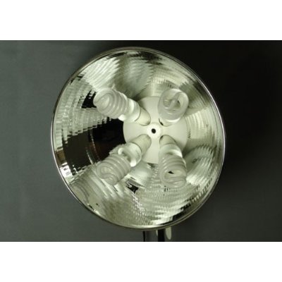

    The next step up would be purchase multiple head reflectors, I have two that hold four bulbs, I've seen a model that holds five bulbs.
    Attachment 64980
    HTH, Cheers, Don
