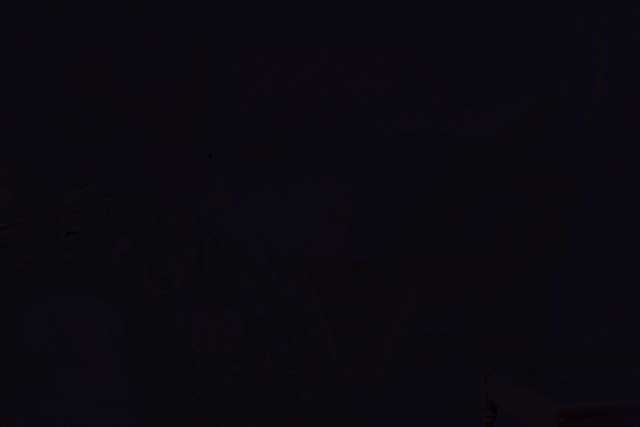

    I always find this intriguing the differences between file formats. Then this week I read an article in a magazine about this and they suggested an experiment to allow people to see the difference.
    Anything that is not pure black is lost data.
    Here is the results for a JPG saved at best quality (12) v TIFF. There is a faint image in this one where it would be a pure black photo if there was no data loss. As you can tell it's not pure black.
    Attachment 63310
    Here is the result for a JPG saved at best quality (8) v TIFF. Well can you guess what it is yet?
    Attachment 63311
    Here is the original taken in RAW on the 5D.
    Attachment 63312
    Hope this helps people understand the difference through a visual comparison.
    You can do this yourself by saving a photo as a TIFF and then as a JPEG. Then add the JPEG as a layer on top of the TIFF layer and set the JPEG layer blend mode to 'Difference' then create a level layer and set to 'Auto' and then flatten. the layers.
