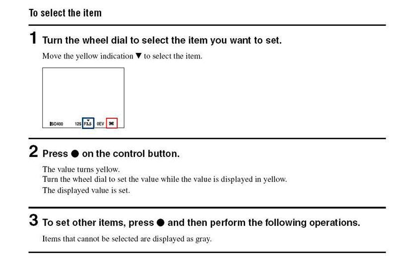

    Please help if you can. I have been using this DSC H 50 for a while and am still learning. (slowly)
    The focus adjustment has been showing in the past but now I cannot seem to get it back.
    Here is a shot of the screen from Disk manual.
    The blue rectangle is in the manual I have added the red rectangle to indicate where the focus selection has been, but is gone.
    I've been pushing all the buttons and turning the wheel but cannot solve this puzzle.
    Thank you for help. I have been given a one day course for Jan 29.
    Hope I can get this solved before going to the class.
    Attachment 75220

    I don't know the camera, but looking through the Cyber-shotŪ Handbook:
    - The Focus Method can only be changed in the P, S, A, M or Film modes.
    - When you use Digital Zoom or AF Illuminator, the AF Range Finder is dissabled...
    - You can change the Focus Method only when Face Detection is set to OFF.
    - You can only select Multi AF or Manual Focus when shooting movies.

    THANK YOU! THANK YOU! THANK YOU!
    I did not find that "face detection" would prevent focus adjustment.
    That solved my confusion. (For the moment :D)
